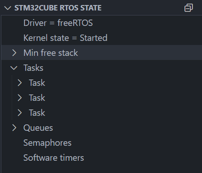

2025-09-02 5:05 AM
Thank you for your response! It really worked! However, now the Task name cannot be displayed directly under the Tasks label; it needs to be expanded to be visible. Is there a solution to this problem?
2025-09-02 5:28 AM
No, for now, the nodes need to be expanded to see the task name.
But thanks for the feedback; we are adding this to our roadmap.
KR,
/Flo

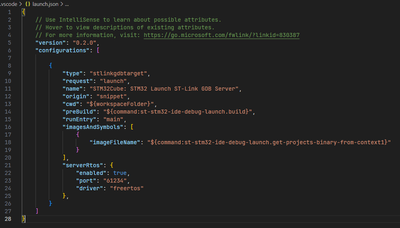

2025-11-26 5:55 PM
I had to change the port to 61234 instead of the suggested 60000. Where can I find documentation on this?

2025-11-27 12:21 AM
That's strange, and if you try again with 60000, is it still failing ?
61234 is the default port of STLink gdb server.
Are you using an STLink or Segger JLink ?
Can you show your launch json file.
Can you show the "DEBUG CONSOLE" log ?
With the default launch as this one :
You should see these traces if using an STLink :
RTOS proxy: Connecting to GDB server 127.0.0.1 on port 61234 ... RTOS proxy: Connected
Listen for GDB connection on port: 60000 ... Debugger connected
connected to remote target localhost:60000
Rgds,
Laurent

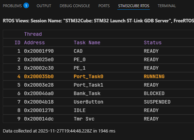

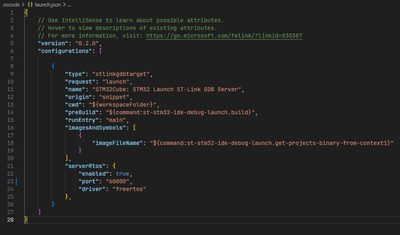

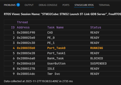

2025-11-27 11:48 AM
Working configuration
I opened the project on another computer and changed the port back to 60000... Which also works now.
Now that I think about it, I was using a different STlink that had been abused (carried back and fourth in a backpack) and was seeing a few connection issues. Next time I do some development on that computer I will try changing the port with a better treated STlink.
