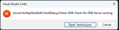

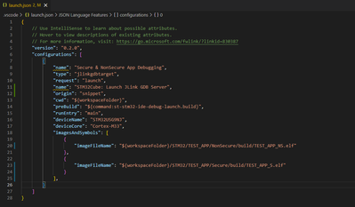

With the new STM32Cube Debug Jlink GDB Server V1.2.0 I'm not anymore able to start the debugging session. If I downgrade to V1.1.0 then it is working again. I get always the error message "No GDB Server running". I tried that with my old launch.json settings and with the new generated and adapted json settings.
error message:

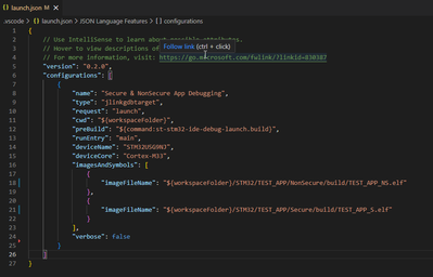

old launch.json
new launch.json

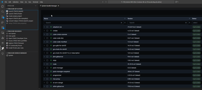

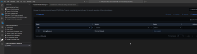

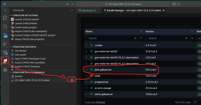

Also, please provide the version of the jlink-gdbserver bundle you are using for your project, which you can find in the Bundles Manager view:

Then I checked the version, there I saw that the jlink-gdbserver was not installed. Then I installed the gdbserver

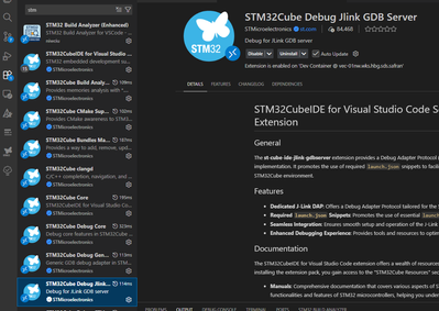

For me it's strange that the jlink-gdbserver was not installed, but the gdb-jlink extension was installed.
Any clue what happens?
Thanks a lot
nobody
2026-03-12 2:31 PM
The STM32Cube Debug J-Link Gdb Server extension contains the implementation of our Debug Adapter Protocol (DAP) for J-Link as well as the JSON schema for the jlinkgdbtarget debug configuration.
The extension does not include the J-Link gdb server binary. That binary is included in the associated bundle. This allows you to have multiple versions of J-Link gdb server installed on your machine (visible from the bundles manager). So maybe version 9.14 was not installed, but another version was.

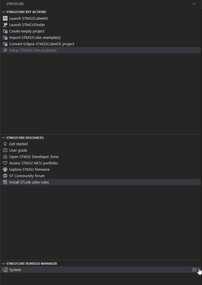

The project setup did not complete successfully. You can redo it by using "Setup STM32Cube projects" in the STM32Cube Key Actions view.

I can not do a project setup, that is in my case greyed out. Why is that not possible? The project is from .ioc generated with the cmake option selected.
Were there any changes made, which explains why the old version is working and the new one not anymore?
