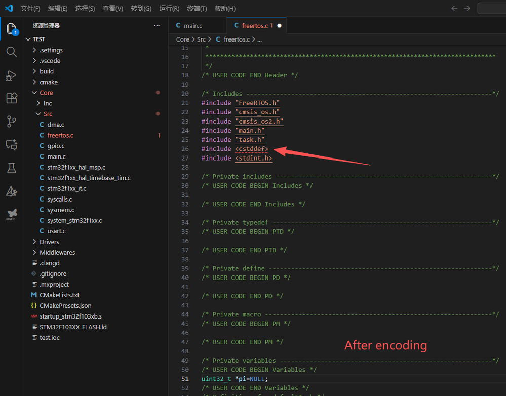

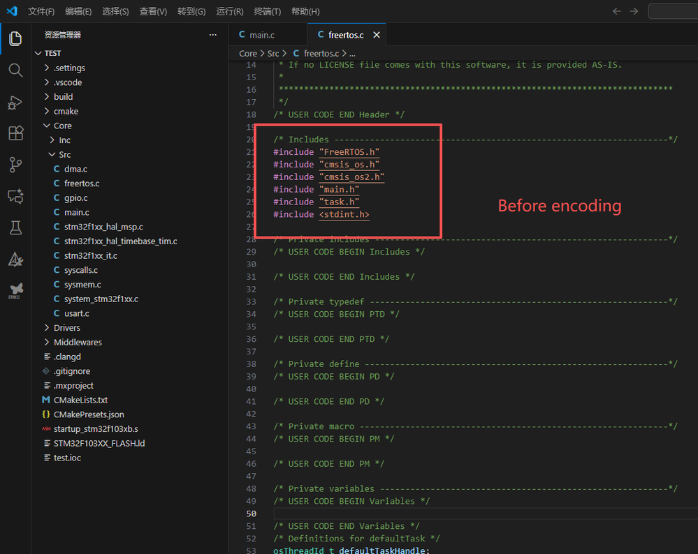

When writing code, it is common to encounter the automatic inclusion of some unnecessary #include statements. For example, when I input "NULL" and press the Enter key, it will automatically add " #include <cstddef> ".

I entered "uint32_t *pi = NULL" in the user code section. When I pressed the Enter key while the code for handling the NULL input was being displayed, it automatically added "#include"

I think this is unreasonable. Firstly, if it is to be automatically added, it should be added to the user code area instead of the current location (because this would be overwritten when generating the code using STM32CubeMX). Secondly, the automatically added "#include <cstddef>" is also incorrect and cannot be compiled. It should be "#include <stddef.h>".

My idea is to avoid automatically adding unnecessary #include statements, or it is not intelligent enough. For example, when I input the "osMessageQueuePut" function, it automatically adds #include "cmsis_os2.h", which is unnecessary because there is already #include "cmsis_os.h" in the current code file, and its internal part contains #include "cmsis_os2.h". Of course, if this cannot be solved, it would also be acceptable to address the issues of adding incorrect #include statements and placing them in the wrong location.
