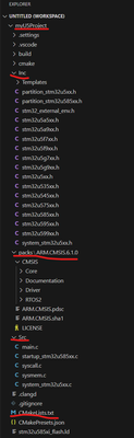

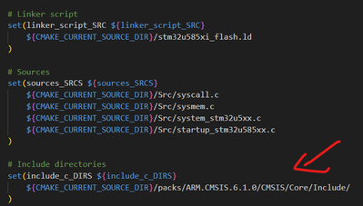

2025-07-07 7:10 AM
This is the first time we are receiving so much emphasis on the empty project feature, to be fair. As shared by @Cartu38 OpenDev , this feature is not new to the STM32Cube ecosystem, but I am very happy to see more traction and comments here!
I have already committed to forwarding your requests to product marketing. We always welcome feedback to serve you better whenever possible. Please could you argue how and why empty projects are convenient to you.
I may also share that we already have some work in progress on this.
May I take this opportunity to share what it looks like on my local (R&D internal) environment at this time to get your feedback? Please comment!
Disclaimer: I cannot commit to any date or .. having such public. However, the more votes and information we have ...
To be fair, one issue we ended up with today is the CMSIS.Core pack size. The empty project disk size is more than twice as large, thanks to ... It is hard to pick only a small part due to license concerns, so we have to keep it as original.
PS: Thanks @Kraal for bare metal naming proposal may make sense.
2025-07-07 10:43 AM
Hi Vincent,
That looks promising---thanks for sharing!
Before trying out the VSCode extension, I was not a Cube user. I would sometimes download the Cube package for my chosen MCU, in order to search through the folders and extract a few hundred kb of CMSIS header files, which I would then manually copy over to my own Makefile-based or VSCode/Cmake-based build system. I prefer to write all of my STM32 projects using the CMSIS register and bitfield names directly, i.e. with an editor on one screen and the Reference Manual PDF on another screen.
I bet I am not alone, and this is more common than ST thinks. And maybe ST is now attracting more of these weirdos :) to try out the new extension, as it is perceived as more lightweight and compatible with non-Cube workflows. That could explain the renewed interest in the "empty project" feature. Anyway, I think it would be worth doing this, to keep the STM32 power users happy. The more users the better, right?
Mark
