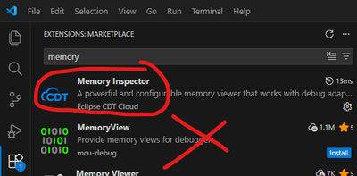

@SharonVEC
About memory inspector takes care to rely on CDT one. Works for me.
If former (2.x.y) STM32Cube extension end user you may get x2 installed what maybe confusing. 3.6.x is pulling CDT one and I guess stuff is validated for usage of such.

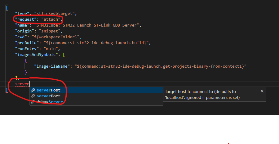

Hi Sharon,
About the attach option:
You need to change the value of the "request" attribute to "attach".
By doing this, you will have access only to the attributes related to the attach option with autocompletion.
The restart button indeed stops the debug session and restarts it, so it reflashes the target.
However, in the next release, the reset button will be available.
Here the template of the debug configuration using attach mode:
"type": "stlinkgdbtarget",
"request": "attach",
"name": "STM32Cube: STM32 Launch ST-Link GDB Server",
"origin": "snippet",
"cwd": "${workspaceFolder}",
"preBuild": "${command:st-stm32-ide-debug-launch.build}",
"runEntry": "main",
"imagesAndSymbols": [
"imageFileName": "${command:st-stm32-ide-debug-launch.get-projects-binary-from-context1}"
"serverHost": "localhost",
"serverPort": "61234"
Kind Regards,
Flo

@Cartu38 OpenDev This indeed was my issue, and the CDT one works fine, thank you!
