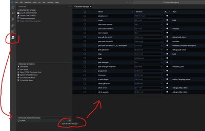

Are you able to get bundles manager populated ?
