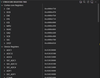

Florent V
Hi @mani9989,
FYI a new release of the extensions containing a fix for this issue has just been published.
The cortex core register are now available directly in the STM32Cube Registers tree view:
Kind Regards,
/Flo
