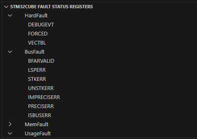

2025-07-16 5:59 AM
you can use the fault status register view in the debug pane of VSCode

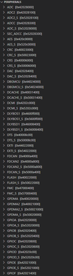

2025-07-16 7:56 AM
i dont see the fault registers

2025-07-18 1:35 AM
so I invite you to use our extension where you will find more features
