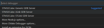

I have setup STM32 VScode extension in my PC, which is awesome. But I found I can not use a Jlink or daplink to flash or debug my board, only STlink is supported. How can I debug with other debuggers in VScode?
Any help will be appreciated.

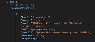

JLink is supported.
Mastering fully your elected probe you can play with so called generic one. More DIY but possible.
