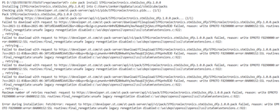

2025-06-30 8:37 AM
Looks like you have a custom openssl install in c:\ws\deps\openssl
If this install is required for something else you may need to set its openssl.cnf to
openssl_conf = openssl_init
[openssl_init]
ssl_conf = ssl_sect
[ssl_sect]
system_default = system_default_sect
[system_default_sect]
Options = UnsafeLegacyRenegotiationI can't try this on my side though.

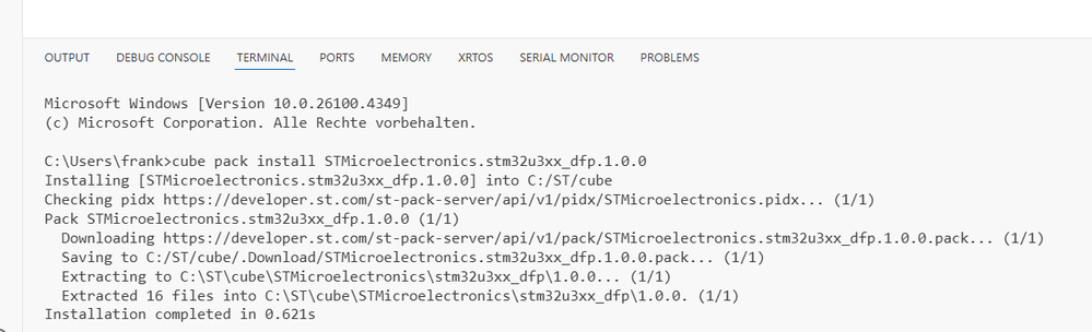

2025-06-27 6:47 AM
Hi @dze.1,
You can try to install manually the missing pack from vscode terminal with the command cube pack install STMicroelectronics.stm32u3xx_dfp.1.0.0 and check if there is any relevant error.

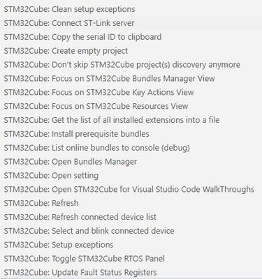

2025-06-27 8:00 AM
thanks for reply.
I should mention I'm using STM32Cube for Visual Studio Code 3.4.11 as recommended in the tutorial.
Neither cube pack install STMicroelectronics.stm32u3xx_dfp.1.0.0 nor STM32Cube: pack install STMicroelectronics.stm32u3xx_dfp.1.0.0 succeeded.
Such a command seems not to exist. I have attached all other available STM32 extension commands below.
But STM32Cube: Synchronize pack list runs without error. But again to no avail.
Thanks.
2025-06-27 9:05 AM
This command is to be entered in the terminal, not in the command palette:
hth
KnarfB

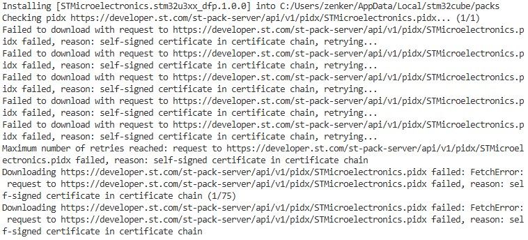

2025-06-27 9:51 AM
Hallo KnarfB,
thank you so much. My fault. I'm new with VS Code (worked for years with CubeIDE).
There seems to be a problem with certificates. May be an IT problem.
Is there a solution to download the packs manually and place them into the expected folder? Since I have CubeIDE and CubeMX heavily in use, the packs shall be already on my machine. May be just a copy is sufficient.
Thank you very much.
Dirk
2025-06-27 10:12 AM
The packs are new with STM32Cube for Visual Studio Code 3.x pre-release. Switching back to 2.x should work.
hth
KnarfB
2025-06-27 1:08 PM
This is indeed an IT issue, all what you should need is to define NODE_EXTRA_CA_CERTS system variable to point to a bundle CA certificates file. Your local IT must be in a position to share this file with you.
2025-06-30 7:43 AM
Hallo Julien,
thank you very much for this indication.
After getting the certificates and the CA bundle file from my local IT and applying it (set NODE_EXTRA_CA_CERTS systems variable to the bundle file and the certificates), the result looks like this:
Failed to download with request ..., reason: write EPROTO F8290000:error:0A000152:SSL routinesfnlr:final_renegotiate:unsafe legacy renegotiation disabled
I gues much more IT problems - surely on my side.
2025-06-30 8:37 AM
[openssl_init]
ssl_conf = ssl_sect
[ssl_sect]
2025-07-02 3:19 AM
Hallo Julien,
I have no openssl installed.
However, I did complain to my company IT again. They solved the problem now. Some server side internal IT stuff I have no insight to. Now it works.
Thank you very much for your help and patience.
