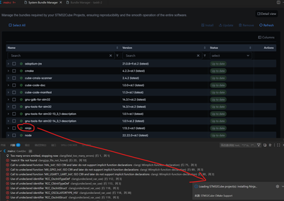

I see 2 errors:
[Error] Failed to initialize STM32Cube bundles: Failed to get list of available updates.
Likely, the cube bundle list-online command run by the extension at startup failed, while a couple of days ago you said it worked fine. Was there any network change in the meantime?
The screenshot notification.
Do you already have any .settings/bundle.store.json file in your project?
If so does it contain Ninja?
Maybe try to do the same operation from the CLI to ensure no useful error message is being hidden by the UI: cube --cwd <project_path> bundle install ninja --project
