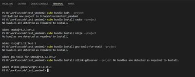

Hi @Julien D ,
I have done the procedures as you instructed as below
the results said "No bundles are detected as required to install", just added all the tools.
then I clicked [Run and Debug], below is the log

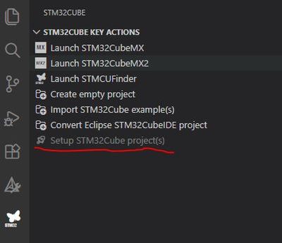

2026-03-19 1:51 AM
Hi @Julien D ,
Yes I have removed .settings/ide.store.json, after excuted the cube bundle commands, I only got 2 json files under .settings. as below
my setup STM32Cube project(s) is gray, it is not active, cannot setup as below.
Thanks.

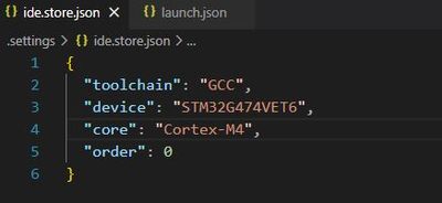

2026-03-19 2:16 AM
Create it with this minimal content and restart VSCode:
"toolchain": "GCC"
}BTW I assume you are using the latest STM32Cube extensions versions?
2026-03-19 2:45 AM

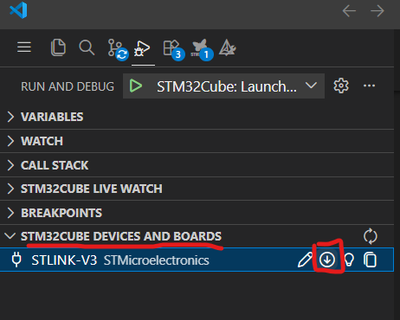

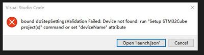

Hi, yes I created the file and input the minimal content, and restart VSCode, choose device and click setup STM32Cube projects(s), save it. now the file is as below.
and I click [Run and Debug], get a result like:
open launch.json, as below
// Use IntelliSense to learn about possible attributes.
// Hover to view descriptions of existing attributes.
// For more information, visit: https://go.microsoft.com/fwlink/?linkid=830387
"version": "0.2.0",
"configurations": [
"type": "stlinkgdbtarget",
"request": "launch",
"name": "STM32Cube: Launch ST-Link GDB Server",
"origin": "snippet",
"cwd": "${workspaceFolder}",
"preBuild": "${command:st-stm32-ide-debug-launch.build}",
"runEntry": "main",
"imagesAndSymbols": [
"imageFileName": "${command:st-stm32-ide-debug-launch.get-projects-binary-from-context1}"
}I still cannot get the debug.
Yes, I am using the the latest STM32Cube extensions versions. because 2 days ago after vscode update to version1.111.0, my STM32CubeIDE for vscode became unavailable as mensionned before, I uninstalled all the vscode and extensions and re-install all the latest versions.
Thanks.

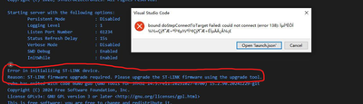

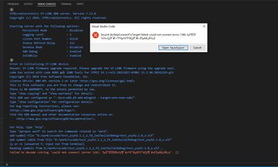

2026-03-19 3:05 AM
Hi @dqsh06,
I see in the debug console that the ST-Link firmware is not up to date.
Please update the firmware using:
Kind Regards,
/Flo

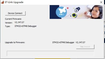

2026-03-22 6:22 PM
Hi All,
I am using stlinkv2, so I have download the latest ST-LinkUpgrade tool and upgrade my st-link tool to the latest firmwire as below
I will try vscode + run&debug, let's see what will happen.
Thanks.
2026-03-23 7:28 PM
Hello @Florent V , @Julien D ,
After I updated the stlinkv2 firmware to V2.J47.S7, click [run and debug], it really can download the image and do the debug.
Thanks you all!
