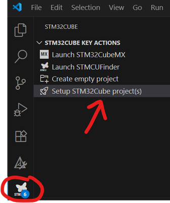

Trying to get the STM32CubeIDE for VSCode working on MacOS. I am on the latest version I think it is 3.6.4.
I installed the extension according to instructions and I made a project for my NUCLEO-446RE with CubeMx.
When I open the folder in VSCode it throws a Bad CMake Executable Error when I open the Setup STM32Cube project(s) section. In the search box in this section it also seems the NUCLEO-446RE is missing as well.

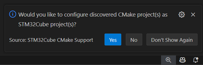

@wljr, regarding the CMake issue, if you do not have CMake installed locally, it is fully supported and expected to face an error. Let me explain what happens behind the scenes.
The STM32CubeIDE for Visual Studio Code extension pack relies on the widely used Microsoft CMake Tools extension. This extension attempts to perform a CMake configure step on any CMakeLists.txt file added to the VSCode workspace. If CMake is not available on your host, it will fail. This is outside of STMicroelectronics’ control since the extension is not ours.
Our responsibility is to notify you when a CMake project is detected, asking if you want to apply STM32Cube’s extra features. If you confirm, STM32Cube will set up the proper tools, including CMake. After setup completes, STM32Cube will trigger a CMake configure process, which should succeed.
Just in case the notification is missing, let's manually invoke the process by using the following setup action:

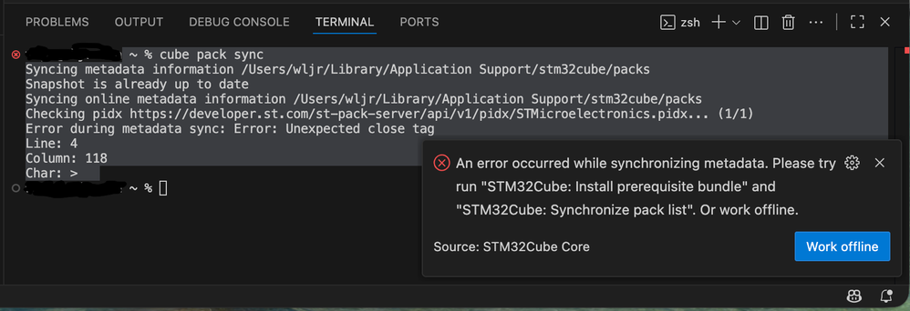

As far as I am aware I am not running any proxy's but this is the result of my cube pack sync and the error in the notification area when it tries to synch the pack list.

The result of cube pack sync suggests that you have corrupted local data, complaining about an invalid XML structure in a pidx file. Could you please remove your local pack repository and restart VSCode? Your local path is:
/Users/wljr/Library/Application Support/stm32cube/packs
Please let me know if this helps. In parallel, I will share this error with the development team for confirmation.

This appears to be a server-side issue: the ST pack endpoint returns an HTML error/503 instead of a valid .pidx XML.
Repro:
$ cube pack sync Checking pidx https://developer.st.com/st-pack-server/api/v1/pidx/STMicroelectronics.pidx... (1/1) Error during metadata sync: Error: Unexpected close tag Line: 4 Column: 122 Char: >
Proxy fetch shows 503:
$ wget https://developer.st.com/st-pack-server/api/v1/pidx/STMicroelectronics.pidx HTTP/1.1 503 Service Unavailable
Direct fetch returns an HTML error page (not XML):
$ curl https://developer.st.com/st-pack-server/api/v1/pidx/STMicroelectronics.pidx <HTML><HEAD><TITLE>Error</TITLE></HEAD><BODY> An error occurred while processing your request. Reference# 30.15b82917.1760947276.5d732b9 https://errors.edgesuite.net/30.15b82917.1760947276.5d732b9 </BODY></HTML>
I have tried deleting the files and re-syncing; the issue persists. In my project’s open-source community, dozens of users over the past few days (from different regions on Windows/Linux/macOS) reported the same problem. This looks like a server-side error — recent sync attempts consistently return errors.
