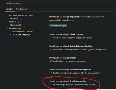

It seems they've introduced a new setting for the clangd extension that controls formatting. It's disabled by default. After enabling the option, automatic formatting started working again.

That's exactly the case.

It tripped me up too as it wasn't very explicit in the release notes.
Thankfully, I stumbled onto this and updated our project's ".vscode/settings.json" to handle this auto-magically.
