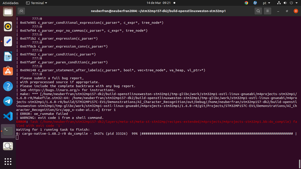

Final part of the issue in screen:
| with preprocessed source if appropriate.
| Please include the complete backtrace with any bug report.
| See <https://bugs.linaro.org/> for instructions.
| make: *** [/home/neuberfran/stm32mp157-dk2/build-openstlinuxweston-stm32mp1/tmp-glibc/work/stm32mp1-ostl-linux-gnueabi/m4projects-stm32mp1/1.6.0-r0/Makefile.stm32:64: /home/neuberfran/stm32mp157-dk2/build-openstlinuxweston-stm32mp1/tmp-glibc/work/stm32mp1-ostl-linux-gnueabi/m4projects-stm32mp1/1.6.0-r0/build/STM32MP157C-EV1/Demonstrations/AI_Character_Recognition/out/Debug//home/neuberfran/stm32mp157-dk2/build-openstlinuxweston-stm32mp1/tmp-glibc/work/stm32mp1-ostl-linux-gnueabi/m4projects-stm32mp1/1.6.0-r0/git/Projects/STM32MP157C-EV1/Demonstrations/AI_Character_Recognition/Src/main.c.o] Error 1
| make: *** Waiting for unfinished jobs....
| make: *** [/home/neuberfran/stm32mp157-dk2/build-openstlinuxweston-stm32mp1/tmp-glibc/work/stm32mp1-ostl-linux-gnueabi/m4projects-stm32mp1/1.6.0-r0/Makefile.stm32:64: /home/neuberfran/stm32mp157-dk2/build-openstlinuxweston-stm32mp1/tmp-glibc/work/stm32mp1-ostl-linux-gnueabi/m4projects-stm32mp1/1.6.0-r0/build/STM32MP157C-EV1/Demonstrations/AI_Character_Recognition/out/Debug//home/neuberfran/stm32mp157-dk2/build-openstlinuxweston-stm32mp1/tmp-glibc/work/stm32mp1-ostl-linux-gnueabi/m4projects-stm32mp1/1.6.0-r0/git/Projects/STM32MP157C-EV1/Demonstrations/AI_Character_Recognition/Src/app_x-cube-ai.c.o] Error 1
| ERROR: oe_runmake failed
| WARNING: exit code 1 from a shell command.
ERROR: Task (/home/neuberfran/stm32mp157-dk2/layers/meta-st/meta-st-stm32mp/recipes-extended/m4projects/m4projects-stm32mp1.bb:do_compile) failed with exit code '1'
NOTE: Tasks Summary: Attempted 4628 tasks of which 0 didn't need to be rerun and 1 failed.
NOTE: Writing buildhistory
NOTE: Writing buildhistory took: 15 seconds
Summary: 1 task failed:
Summary: There was 1 WARNING message.
Summary: There were 2 ERROR messages, returning a non-zero exit code.

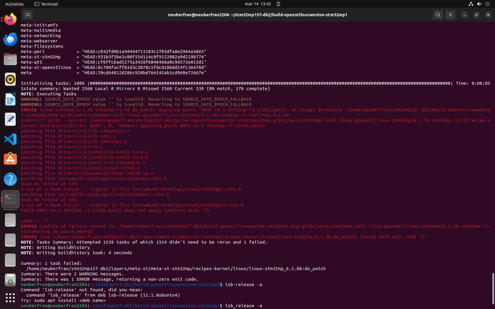

@JeanPhilippeR In Ubuntu 22.04.4 I have other issues:
https://gist.github.com/neuberfran/53edcef12f41014d678b5458bde38e4d

2024-03-15 11:24 AM - edited 2024-03-15 11:26 AM
I have two, because I stay trying in two natives machines (Ubuntu 22.04 and Ubuntu 20.04)
First in 22.04
https://gist.github.com/neuberfran/c352a0841c5e609b5b98265f9fb76b75
Second in 20.04
https://gist.github.com/neuberfran/b084c122d96a301d546cf8d60662fd82

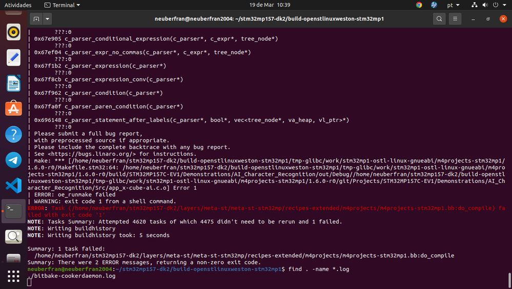

2024-03-19 1:19 AM
Dear @neuberfran
We do not find any clue on your log which allow to highlight host configuration issue, or missing dependencies.
Could you please execute the following command:
$ bitbake linux-stm32mp -c cleansstate && bitbake st-image-weston
Then if will fail, share the log resulting from those 2 commands.
Thank you
BR
Jean-Philippe
