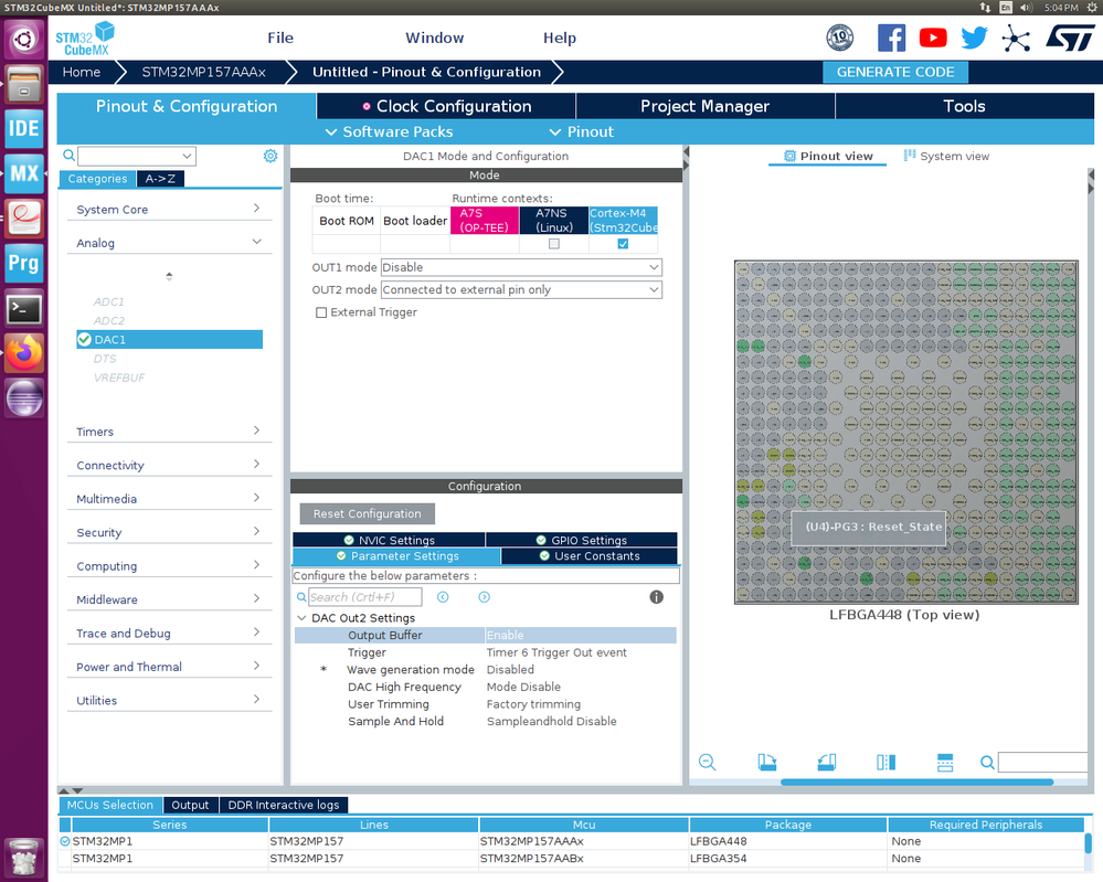

We are using Stm32mp157a Processor in Our custom board.
We are configuring PA5 as DAC1_OUT2.We want to configure DMA for DAC. But we didnot get an DMA setting tab in DAC configuration in stm32 Cube mx.How do i enable DMA for DAC? You can see in below Attachment.

Hi @Sindhu Vadde ,
you are right, seems missing on STM32CubeMx.
I think feature is available inside STM32CubeMP1 HAL by manually adding relevant inits and function calls in your code.
We are checking this internally and come back to you.
Regards.
