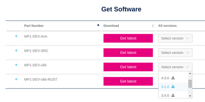

I'm trying to download SDK version 5.10 to build the version of Linux kernel used in our product after some years, i understand the file we need is
en.SDK-x86_64-stm32mp1-openstlinux-5.10-dunfell-mp1-21-11-17.tar.xz
unfortunately I get V6.x regardless of what I select on the download page. Would someone have a link to this file? (it's almost a gig)

Hello @SimonJFisherMB ,
On the following link: https://www.st.com/en/embedded-software/stm32mp1dev.html
Do you well try to download this, with choosing version 3.1.0 (that corresponds to the OpenSTLinux version with Linux kernel 5.10):
It seems to work on my side.

2025-03-28 2:30 AM
Selecting version 3.1.0 I get the proper SDK
Maybe confusion between kernel version and openstlinuxversion ?

2025-03-28 2:41 AM
yes I was mixing up the versions. My apologies guys thanks for looking into it.
