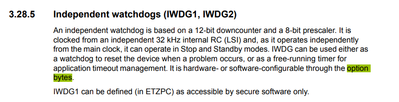

2023-11-21 2:44 AM
Hello @Erwan SZYMANSKI Hello @PatrickF
I got some info from here https://www.st.com/resource/en/datasheet/stm32mp135c.pdf :
it's seems like "option bytes" could disable it.
As the experience from other controller, once we disabled it from option bytes, then it can not abled by SW.
But I don't know which SW can used to set option bytes. Need your help.
I'm first time use STM product.
2023-11-21 7:54 AM
Hi @mingming ,
OTP (equivalent to option bytes on STM32) could only define if Watchdog is started by HW after reset or start by SW.
Once set to be started by HW, you can't revert OTP settings.
By default on our boards, it is start by SW, so you should simply disable it in Device Tree as told by @Erwan SZYMANSKI .
Regards.
