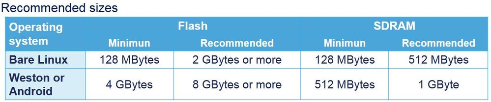

What are the minimum RAM size and FLASH size to run Linux?
Also looks like stm32MP1 does not have CAN bus, is it right?
For better community usage, for new question/concern, it is recommended to open a new thread.
Some STM32MP1 part number have CAN bus https://www.st.com/content/st_com/en/products/microcontrollers-microprocessors/stm32-arm-cortex-mpus/stm32mp1-series.html
For recommended memory size, please have a look to STM32MP1 EXTMEM training https://www.st.com/content/st_com/en/support/learning/stm32-education/stm32-online-training/stm32mp1-online-training.html
