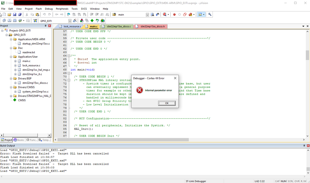

Today I tried the to flash the "GPIO_EXTI" with MDK 5.29 and a MDK essential license in engieering mode to STM32MP157C-DK2.
This time the error "no algorithm found" does not show with the same settings, but when trying to flash, an error dialog saysing "Internal parameter error" pops up.
Can somebody help me here?
2021-08-16 7:35 AM
Hi BRein.2 (Community Member)
Unlike STM32 MCUs. There is no embedded flash in the STM32MP157. In Engineering mode, the Cortex M4 access the MCU_SRAM by default. Therefore make sure the sct file points to MCUSRAM (follow https://www.keil.com/appnotes/files/apnt_319_v1.2.pdf) and you must disable the flashloader in the IDE debug connexion.
