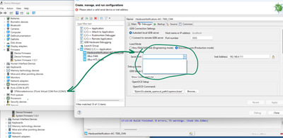

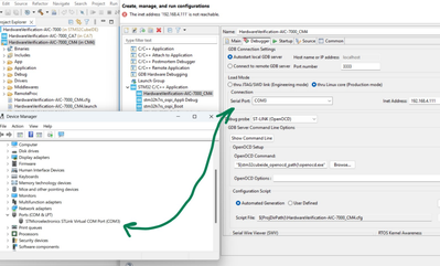

We've also tried the same on STM32CubeIDE running on Win11 computers. And it all worked fine for some and not for others. E.g. On some laptops it works OK but on others it doesn't let us select "MPU Serial" console even it was recognized as STLink Virtual Port.
E.g. This is an example of working setup on Laptop1:
And this is an example of how it doesn't work on another laptop Laptop2 :
As it is clear Win11 correctly detected ST-Link Virtual UART but it is not showing in STM32CubeIDE as it does on other laptop. We tried it on several laptops and it worked on some and doesn't on others.
