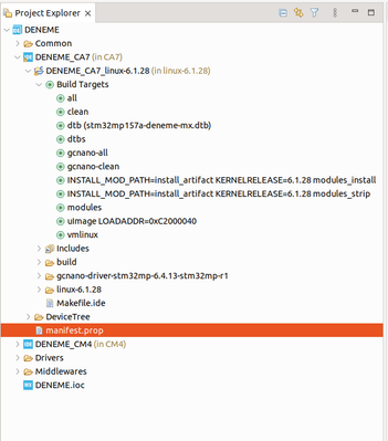

I reviewed the relevant links. I was able to solve some of it. I have an STM32MP157DK1 Eval board. I haven't been able to start a project using the STM32Cube IDE and run it on the board yet. My project file is as in the picture. I understand how to proceed to debug or develop code....
Sincelery
