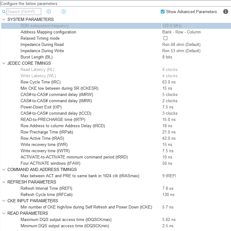

I'm using the Winbond W97AH6NB / W97AH2NB RAM. The CubeMx RAM configuration looks like this:
My current questions:
Regarding the relation with the DUF problem: it can be that the RAM is still not fully functional when the TF-A starts writing the layout on it with the programmer, and for this reason it gets corrupted.

2022-05-12 8:46 AM
I suspect also an issue with the LPDDR2. Not expert enough to comment your values.
Please confirm you have a 100 ohms resistor between DDR_CLKP and CLKN (close to LPDDR pins). We recently discover that this info is missing in AN5031, but present in AN5122 and routing examples.
Btw, please double check the tf-a-serialboot.stm32 you are using is really using the same parameters you have in tf-a-trusted.stm32 (as you mention that you boot up Linux, so likely using this latest one).
As it seems you are using 800MHz without STPMIC1, please confirm your VDDCORE is set at 1.35V before going above 650MHz.
I see you are using Ecosystem V3.0, I encourage you to move to latest Ecosystem v3.1 which has (beside other updates) one specific update for LPDDR (not sure it is linked to your issues)
