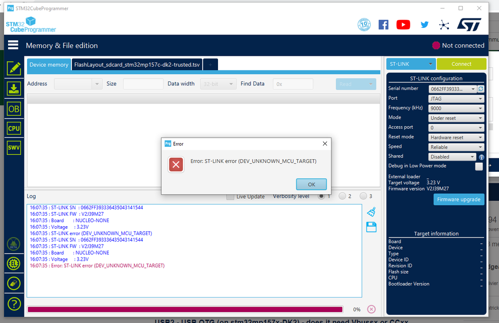

I have been trying to connect to stm32mp157x-DK2 via on board stl-ink and to my custom board via stlink-v3set, using the STM32CubeProgrammer, but on both boards I get the same error. I have tried selecting engineer and productions mode - no luck. What am I doing wrong? - see a picture bellow

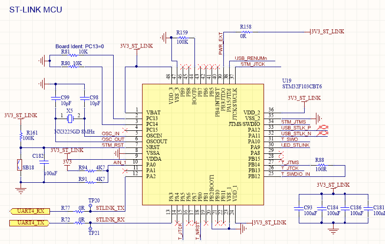

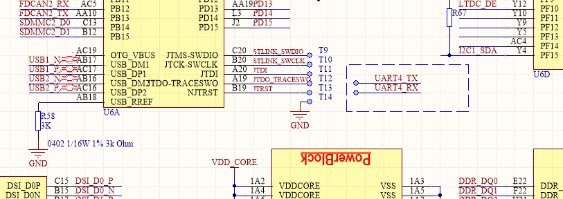

Also why stm32mp157x-DK2 - allows full access via uart to boards memory and custom board does not (see schematics bellow)
1.pic. J-tag error of not detecting MPU on eval-board.
2.Pic. Eval-board st-link schematics.
3.Pic.Custom board - pins that connects to STlink-V3set.

Software looks to be using a ST-LINK V2, not a V3
NJRST != NRST
The NUCLEO board needs to have it's target physically disconnected, for JTAG be specifically aware of SWO/TDO pin as this is not addressed by the SWDIO/SWCLK connection jumpers.

The screenshot is the the eval-board yes it's V2 link not V3 - my bad sorry. But the stm32mp157x-DK2 should be able to access the target MPU via ST-link using cubeMxprogramer - in for example engineering mode, or am i misstaken?
