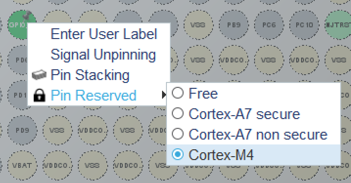

GPIO pin context is assigned at the pin level.
Right click the pin in pinout view -> Pin Reservation -> Cortex M4

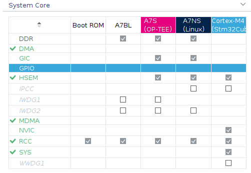

It gives me no option to select the target for GPIOs:
2022-03-29 9:33 AM
2022-03-29 10:04 AM
Thanks, that was a new (hidden) option for me!
