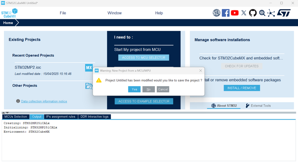

I’m unable to create a new project for the STM32MP2 (STM32MP251CAL3) in STM32CubeMX (Version 6.14.1). After selecting the MPU and clicking Start Project, I choose the TrustZone feature—but nothing happens. I can see a “*” appear next to “Untitled” in the top left, but no further dialog appears.
When I try to select an MCU, I receive the warning:
“Project Untitled has been modified would you like to save the projekt?”
If I click Yes, the mouse cursor turns into the blue loading spinner and nothing else happens.
In the Output window, I see:
Creating: STM32MP251CALx
Initializing: STM32MP251CALx
Environment: STM32CubeMX

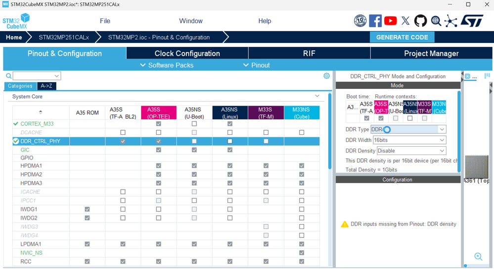

Even when editing an existing project, I can click options in Pinout & Configuration, but the cursor just shows the blue loading spinner and nothing else occurs.

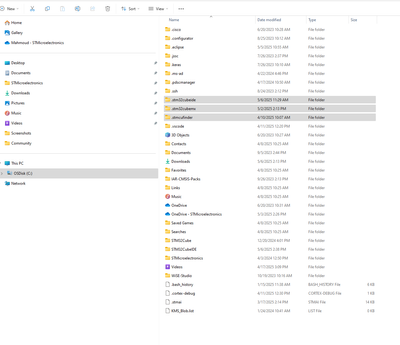

2025-05-06 6:57 AM
Hello @pp24 ,
I have well received your screen recording and I was not able to reproduce your issue.
The problem is related to your environment.
I suggest that you delete the cache.
