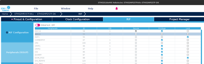

2025-09-16 11:11 PM - edited 2025-09-16 11:14 PM
On the file you share we can see:
| Peripheral name || Firewall ID || N/SECURE || N/PRIVILEGED || CID filtering || Semaphore mode || SCID || SEMWL |
| ADC12 || 58 || NSEC || NPRIV || disabled || disabled || 0 || 0x0 |
| ADC3 || 59 || NSEC || NPRIV || disabled || disabled || 0 || 0x0 |
If you want to use the ADC with the M33 you need to set the Compartment IDentifier (CID) to 2. You need to reviews your configuration. If you use CubeMX you can quickly see which CID is set for your peripherals as you configure their pinout.
Finally, you can refer to the RM0457 9.4.6 RIFSC control of peripherals (RISUP) for more details.
I hope this will help you.

2025-09-17 6:21 AM
CubeMX looks the same here. Can you tell me which file to edit to get this CID configured?
