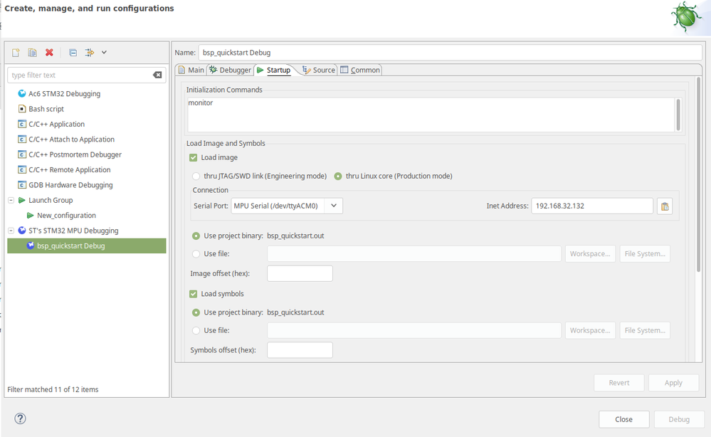

2019-07-12 12:34 AM
hi Oliver,
Thank you for quick answer. IP address is set correct bcause it is working for OpenAmp_TTY_acho.
it isn't showing me any error in main and Debugger windows, They looks like as follow:
BR
Bhinder

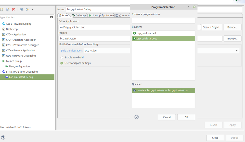

2019-07-12 12:41 AM
Hi Bhinder,
I see you are using .out ?
Only .elf format is supported for M4 firmware.
Olivier
2019-07-12 12:51 AM
Hi Oliver,
I first taught the same and i have already tried with .elf format
OUTPUT(./out/bsp_quickstart.elf elf32-littlearm)But .elf format isn't helping in this case either.
