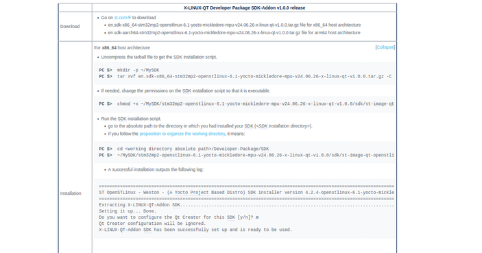

I went with developer package as i was not able to do the distribution package
so the steps i followed for developer package was
i downloaded the MP1-DEV-x86 from st website
For x86_64 host architecture i Uncompressed the tarball file to get the SDK installation script. and Ran the SDK installation script.
for x-linux-qt developer package i downloded the below file(but my board is stm32mp157d-dk1)
i followed these steps

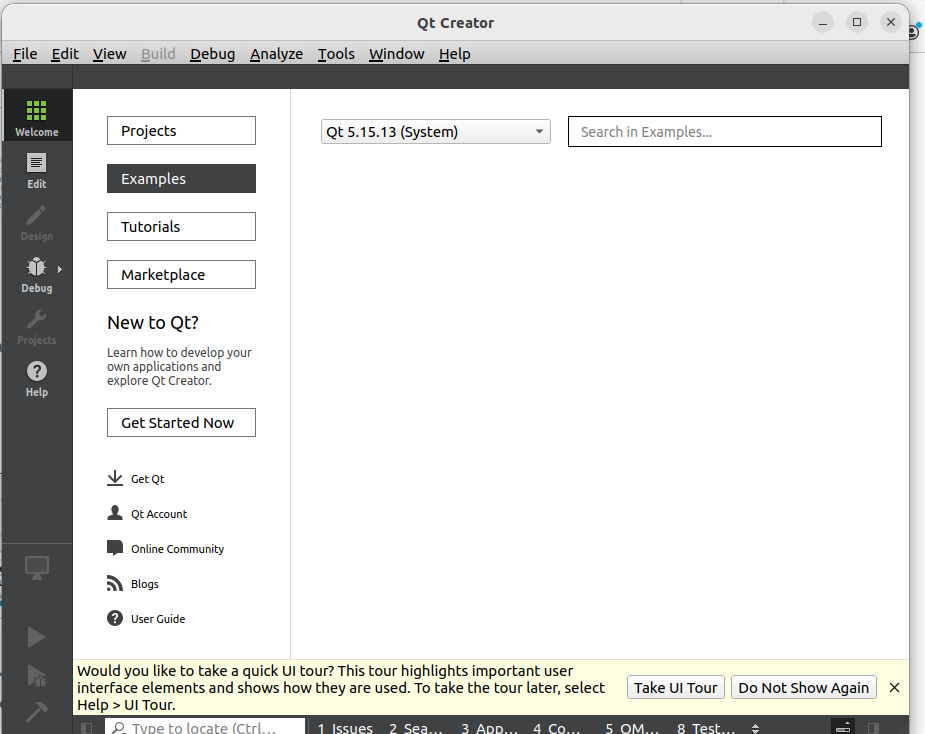

in the terminal i download qt creator using sudo apt install qtcreator and it installed (qt 5.15.13) and u had said Qt Creator will be configured automatically and you will get your MPU kit all set in Qt creator. but i cant find anything other than Qt 5.15.13(system)

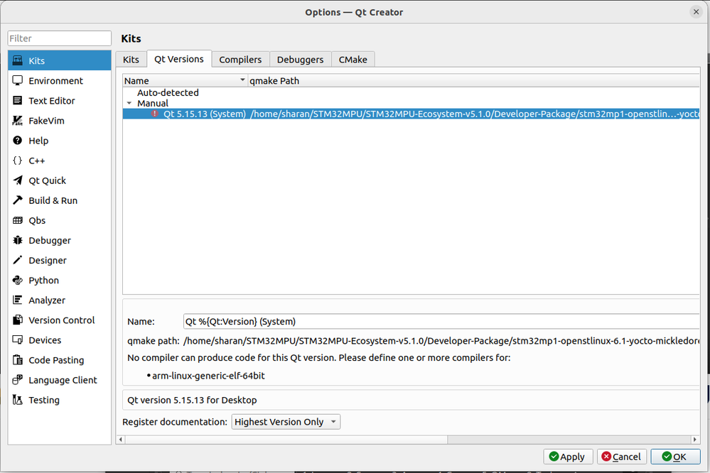

2024-10-14 12:37 AM - edited 2024-10-14 12:39 AM
i am doing it manually it is showing no compiler can produce code for this qt version
2024-10-14 12:41 AM
Please look at the post I listed before, it will describe how to get the SDK and how to use it
(bitbake st-image-qt -c populate_sdk, ...)
