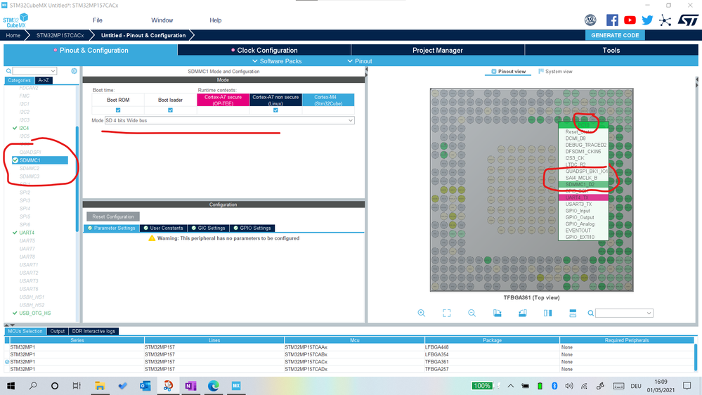

I'm configuring my STM32MP157C-DK2 Board pins and i want to make two SD Card partitions availabe.
For the first one i chose the SDMMC1 and attributed it to PC10 pin
for the second one do i need to choose SDMMC2 and to attribute it to another pin (for ex. PC6) or is it wrong ?
Or can i divide later in the device tree ?

please note that on DK2 board, SDMMC2 is used for WLAN.
You could have both SDMMC1 and SDMMC2 used for two SD-Cards if you build your own specific board, but it is not possible to assign the two as boot (the second card will be seen as an additional filesystem which might contain data or even kernel).
SD-Card boot could be either SDMMC1 on default pins or SDMMC2 when defined by OTP (not reversible). This is a fixed choice.
In OTP, you could define a primary and a secondary boot source, but both should be on a different kind of memory (e.g. Serial-NOR + SD-Card). i.e. SD-Card +SD-Card on two different interface is not possible.
See https://wiki.st.com/stm32mpu/wiki/STM32MP15_ROM_code_overview#Configuration
Regards.
