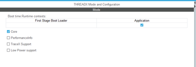

Have you enabled THREADX as below, it should be enabled before NETXDUO.
Thnx
Souhaib
