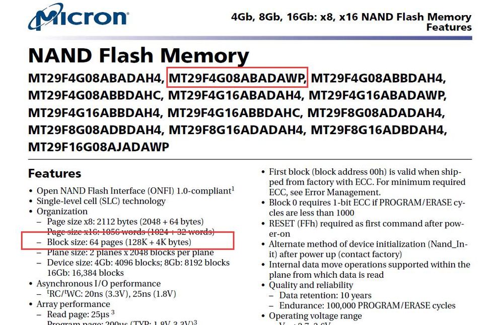

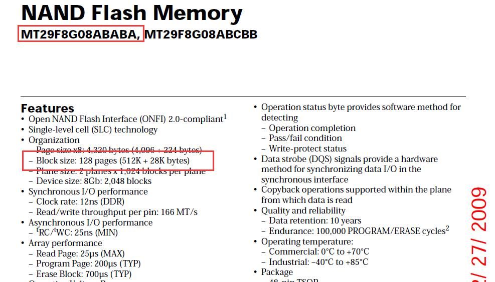

I have checked the datasheet from Micron, and both MT29F4G08 and MT29F8G08 have the block size of 128k. Could you please provide the full part number of the two NAND?
Also, can you provide the flash layout? I mean, the content of the file FlashLayout_XXXX.tsv ?
Thank you for your quick reply, the following pictures are datasheets of the two NAND, please check them.
Sorry, the full name is MT29F8G08ABABAWP-ITC , and it's block size is 512KB,
The full name of MT29F4G08 is MT29F4G08ABADAWP-ITD , and it's block size is 128KB.
