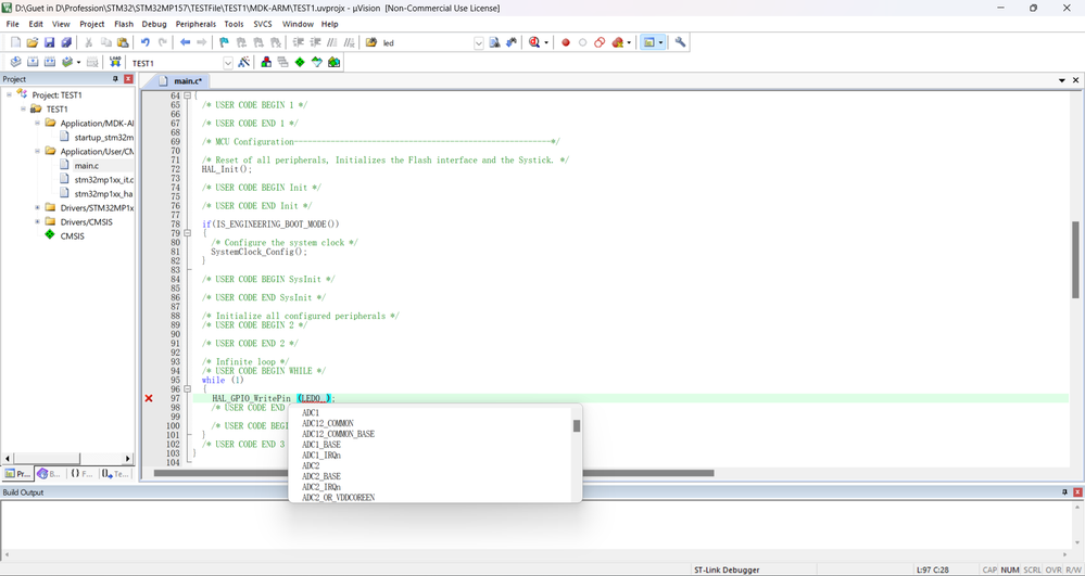

i also find some people say this is a bug,repeatedly click the setting of user label can be solved,but i try it's can‘t figure it out.....
By the way,GPT also not give the correct solution (this is why i am here)

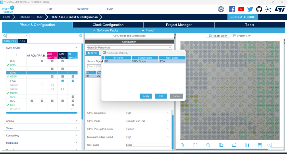

2023-03-28 8:56 PM
i create from scratch,but it's not work.

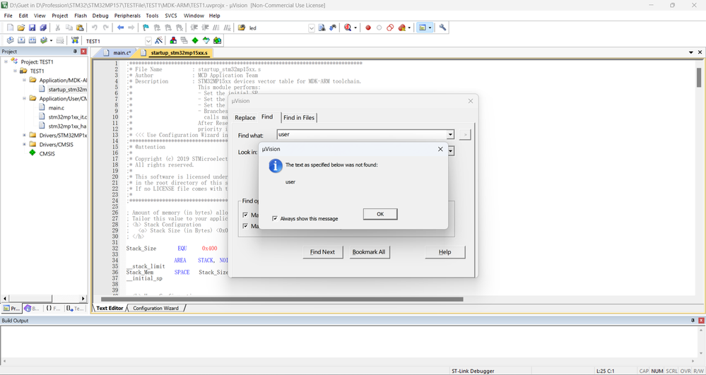

tips:this search is because GPT tell me if the user label exists, there will be appear some words like ".user intt"(something like this) in this file
2023-03-29 12:09 AM
Hi @GGree.2 ,

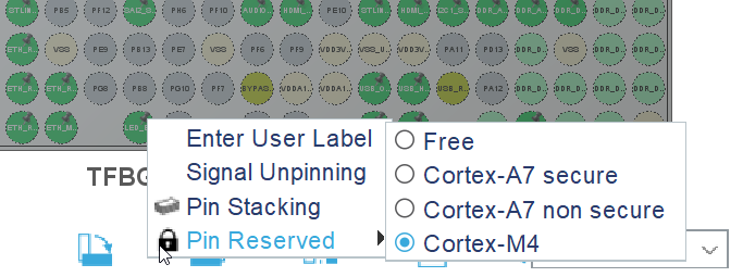

Did you assign the GPIO "LED0" to cortex-M4 ?
Olivier

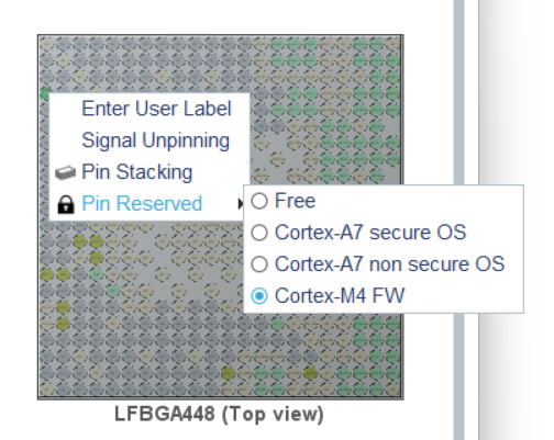

2023-03-29 2:28 AM
i did it but it's not work,however there is something werid,my Pin Reserved of Cortex-M4 is follow a word "FW"
like this
