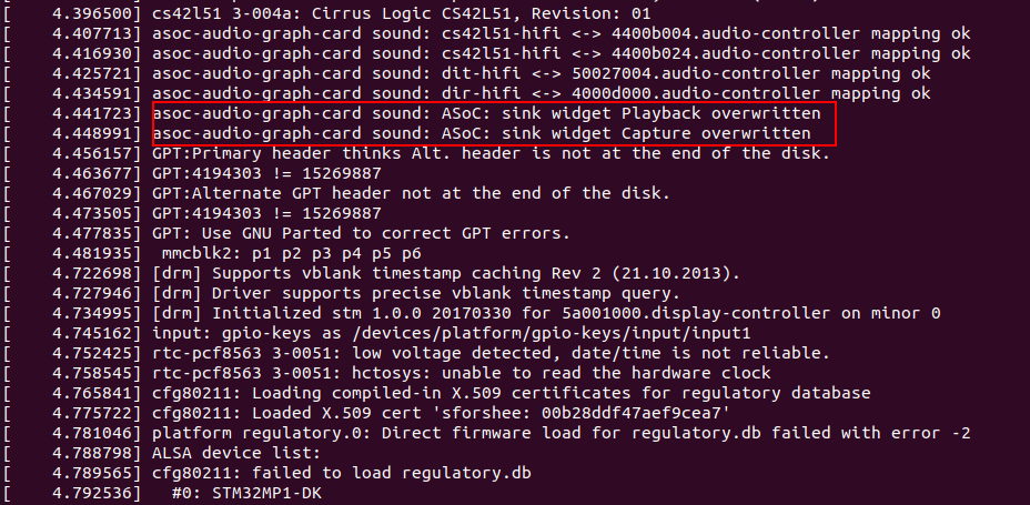

};With this device tree configuration, the following error occurs. Remove the node &sai4a_port in DASI, and audio can be used. How do I modify the node &sai4a_port
[ 4.441723] asoc-audio-graph-card sound: ASoC: sink widget Playback overwritten
[ 4.448991] asoc-audio-graph-card sound: ASoC: sink widget Capture overwritten

As long as CS42L51 and &sai4a_port are both in dasi, CS42L51 will report the following error

We had this kind of error in the past with digital microphone DT entries : the problem was coming from dapm widget names and audio interfaces which were identicals.
It has been fixed by adding a prefix :
dmic1: dmic-1 {
compatible = "dmic-codec";
#sound-dai-cells = <1>;
+ sound-name-prefix = "dmic1";
status = "okay";Hope it will help,
BR,
Christophe
