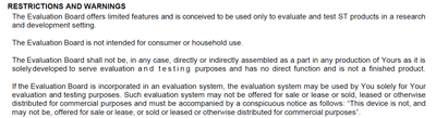

The board reference is only present on ST board and linked to specific OTP programmed during ST board production.
What is the purpose of changing this information while using ST Evaluation board?
I remind you cannot use ST evaluation board outside evaluation purposes (i.e. no commercial usage of ST evaluation board).
See Terms of Use
