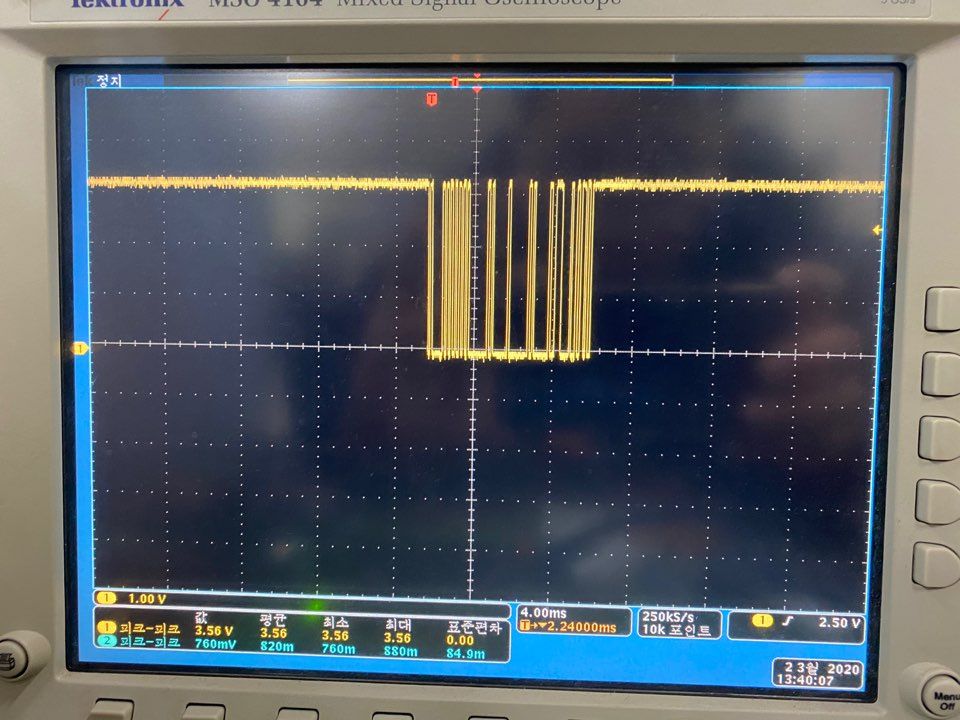

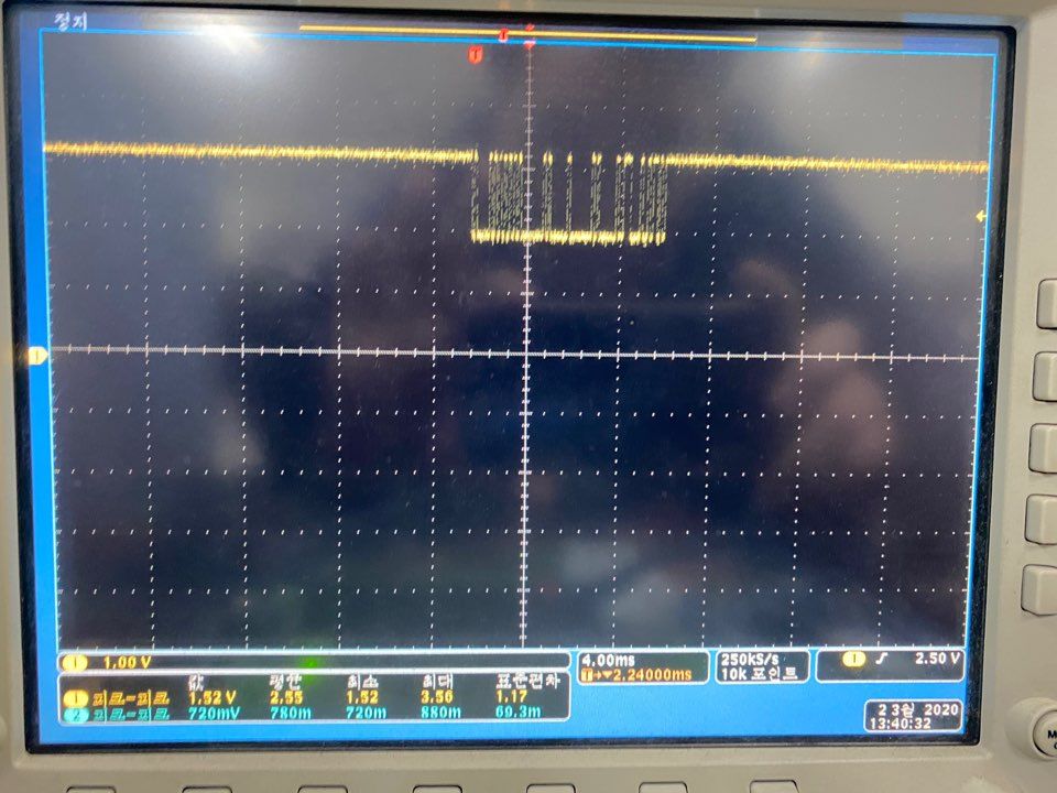

}The Rx signal level is abnormal like the following.
The low level is not the zero(ground) level.
But the Tx level is ok like the followings.
Although I detach the RX Pin from the PCB Board, and tie with the TX Pin,
RX/TX Pin level is like the abnormal level(the first image)
Is the initialization is wrong?
