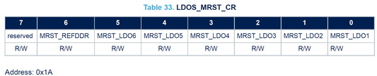

Hi roland van straten,
you need to program the below address, see STPMIC1 DS rev.10 @page83
set bit to 1 active mask reset option for selected LDO for next
reset power-cycle. It is a single shot option and then register is reset to default
Regards
Vincenzo

please have a look to this thread :
you could setup any Buck or regulator to 'ignore the NRST' (in some extend, see note below) by setting the relative MRST_xxx bit(s) in STPMIC1.
Note: these registers are volatile and should be written on each SW boot (i.e. each NRST cycle). That mean if NRST is pressed again before SW programming, the regulator will do a power cycle. This is usually not a big concern as in a final product there is usually no direct HW reset button.
Regards.
