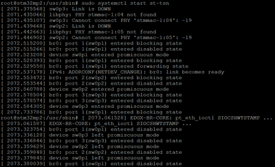

2024-09-18 8:41 AM
This service will not start, nor does running the script manually work.

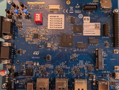

2024-09-19 3:10 AM
Could you please share a photo of your board (taken from above)
2024-09-19 3:19 AM
2024-09-19 3:24 AM

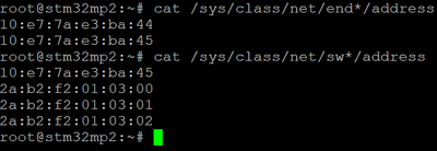

Ok no issue. Sorry but I don't see what could be the issue. What is the result of these 2 cmd below on your side ?
root@stm32mp2:~# cat /sys/class/net/end*/address
10:e7:7a:e3:b8:e1
10:e7:7a:e3:b8:e2
root@stm32mp2:~# cat /sys/class/net/sw*/address
10:e7:7a:e3:b8:e2
ba:9a:c5:9b:b2:00
ba:9a:c5:9b:b2:01
ba:9a:c5:9b:b2:02

2024-09-19 4:45 AM
In term of HW all seems ok.
