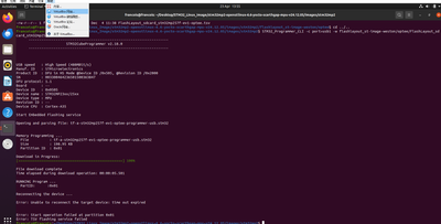

I met this error and can not continue flashing the board. Could any one help me? All configurations are same with https://wiki.stmicroelectronics.cn/stm32mpu/wiki/STM32MP25_Evaluation_boards_-_Starter_Package#Downloading_the_image_and_flashing_it_on_the_board

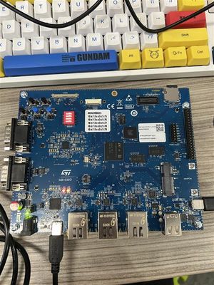

My board is STM32MP257F-ev1, I just followed the sequence to flash my board, but failed.
ld5, ld6 and ld11 are lighted when I start with usb/uart boot.
PS: the system is Ubuntu 20.04 on a VirtualBox VM, And I can use Windows to flash the board, and I still can use this VM to flash the SD card with raw image. But the image will no be flashed via Ubuntu on normal flashing with this EVB
20250519:
I use windows to flash this board without any problems. But seem I can not use virtualbox based ubuntu 20.04 to flash.
