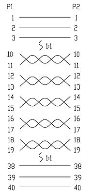

Receptacle on both EV/DK board are the one listed in board BOM, e.g.
| CN2 | Socket_FFC/FPC, 40pins, 0.5mm, RA, SMD, T=1mm | I-PEX | 20455-040E-76 |
Display use JAE HD1S040HA1
The LVDS cable is stated using 2 x JAE HD1P040MA1 or equivalent plug connectors.
Cannot answer for other points, but I think the pinout come from LCD manufacturer (as we use an almost standard display).
Regards.
