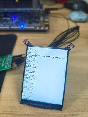

I am using STM32MP257DAK3 with two different MIPI-DSI LCD panels:
Panel A: MIPI-DSI 4 lanes
→ Works correctly in U-Boot using bmp display
Panel B: MIPI-DSI 1 lane
→ Does NOT work in U-Boot using bmp display

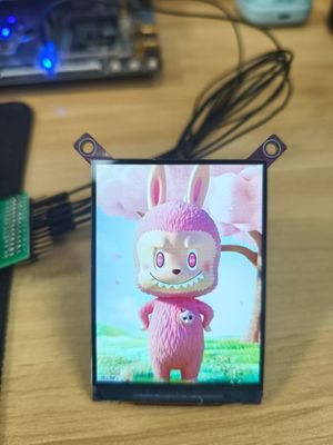

2025-12-21 5:17 PM
Yes, the U-Boot DSI driver (drivers/video/stm32/stm32_dsi.c) officially supports MIPI-DSI 1-lane mode.
I have successfully brought up a MIPI-DSI 1-lane panel in U-Boot on STM32MP25.
After verification:
The DSI host is correctly configured to 1 data lane
No hard-coded 4-lane limitation exists in the current U-Boot implementation
The issue was not a BSP limitation or known issue
The U-Boot DSI driver works as expected for both 1-lane and 4-lane panels, provided that:
Device tree configuration is correct
Panel initialization sequence and timing parameters match the panel datasheet

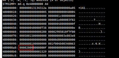

I have performed additional debugging in U-Boot by directly reading the DSI registers.
Register DSI_PCONFR at address 0x480000A4
Value read: 0x00002000
According to the STM32MP25 reference manual, this value corresponds to 1 data lane configuration.
