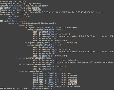

Here the output for channel 0 again as screenshot, with nicer formatting:
While the "input/output error (5)" seems to persist, there are trigger attributes listed now which haven't been there before.
Which is fine for me right now, so I will mark this thread as "solved". Perhaps I come back to this topic later.
