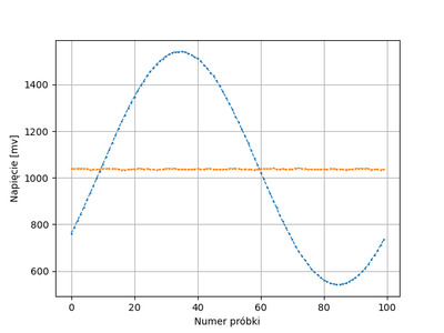

I tested the configuration by measuring 100Hz sinusoidal signal made with a function generator at different sampling frequencies. The sampling frequency value was set to 10000Hz in iio user space as displayed in iio_info (important later):
attr 0: sampling_frequency value: 10000
The signal was measured with the iio_readdev | hexdump command and ploted on a graph
Blue is 100Hz, 1Vpp amplitude, 1V DC offset sine (ignore orange).
The sine looks good and it takes 10kHz/100Hz=100 samples to display a full sine period, so everything works correctly.

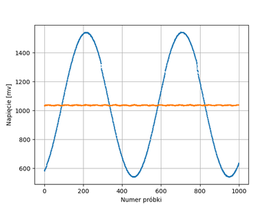

The sampling rate was then set to 100kHz (which should be achievable) and the same 100Hz signal was measured. While setting the frequency, a weird iio_info output was observed (set frequency 100037 instead of 100000):
attr 0: sampling_frequency value: 100037
While measuring and plotting with with the iio_readdev | hexdump the iio library returned this message:
WARNING: High-speed mode not enabled
In the correct signal, one sine period should take 100Khz/100Hz=1000 samples. Here, it takes around 500 so it's around 50kHz. The other problem of my approach is the visible sample skipping artifacts (for example around 800th sample).
