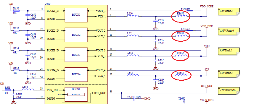

we use the STM32MP157C with almost the same RAM layout as the STM32MP157F-EV1, except that the SDRAM chips are from Micron (MT41K256M16). The PMIC is also the same as the one on the evaluation board, and the settings therefore are identical. TF-A, optee, u-boot and kernel are active.

2026-01-09 2:11 AM
Hello Nicolas,
a brief update on the solution to the problem:
Due to electromagnetic compatibility, ferrites were installed in the VLX paths of the PMIC voltages. With the 0 ohm resistors, as also found in the EVAL design, the RAM problems are eliminated. Memtester runs without any problems.
Thank you very much for your ideas and help!
Best regards,
Nico

Walking Zeroes : testing 23In addition, we have encountered problems with the PMIC in the newer revisions. On some boards the PMIC only supplies 0.9V on VDDCORE at startup, but according it's registers should supply 1.2V. ALTERNATE mode should be off, still investigating here.
However, there have been no changes in hardware design on these paths, neither to the RAM nor to the PMIC.
Whether PMIC and RAM are related to each other is also unclear to us at the moment.
And last but not least we are in contact with the manufacturer of the PCB and have now heard that there was a change of it's supplier between the first and newer revisions of the board.

2025-12-08 5:51 AM
Hello Nico,
Reading your last message make us think that the first thing you have to investigate on is the PMIC sub-system. Observing this 0.9V on VDDCORE is not normal as you can imagine. This could be a layout issue, but also a too high voltage accidently applied to supply the PMIC (maximum without damage is 6V).
When this first part is totally understood, then it will be time to focus on DDR. VDDCORE is a pilar for the DDR sub-system, it has to be at expected value to make DDR sub-system (and its PLL) working correctly.
Your memtester's logs show a weakness on data bit 0 where failures seem present.
It could be interesting to contact the PCB supplier and confirm that data single impedances agree with specifications, i.e. @ 55ohms (+/- 10%).
These are some tracks to follow up, with possible further steps, but the "road" can depend on the progress on your side also within the different investigations you are presently doing.

2026-01-09 2:11 AM
Hello Nicolas,
Best regards,
Nico
