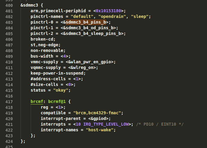

I want to use the mp157 sdmmc3 feature, but it seems he didn't turn it on, because my wifi device doesn't work, do I need to turn on the clock elsewhere?:loudly_crying_face: :loudly_crying_face: :loudly_crying_face:

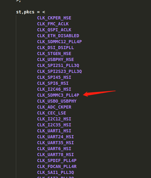

If custom, the clocking of the sdmmc3 is set on the TF-A device tree, I'll invite you to check if it's correctly clocked.

Yes,​ I am using the custom board,but in the TF-A device tree ,the clk of sdmmc3 looks well?:grimacing_face:
‎2019-11-22 12:48 AM
It seems that your clock is correct,
I've seen that you've changed the power supply in the DTS when I it compare to the DK2 wifi configuration,
May I ask you to check the hardware to see if it's a power problem, not a clock one ?

​I tested the wifi voltage, which is normal.
Does wifi need to be loaded into the system as a module, if I compile directly into the uImage file, is it also possible?
The other problem is that I renamed sdmmc3 in dtsi, but it doesn't seem to have any effect on rootfs at startup.:fearful_face:
