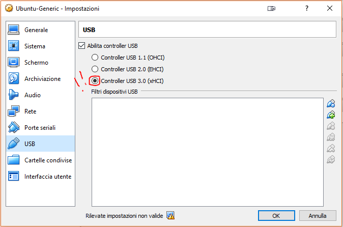

2019-04-15 8:36 AM
Buongiorno Giacomo,
I succeed to replicate your issue but only after I set ST-Link at extremely low speed, using the OpenOCD command "adapter_khz 1".
In such conditions I get, as in your case, both:
I'm surprise you get such issues while your OpenOCD reports "adapter speed: 5000 kHz".
The only explanation I have is that your ST-Link is connected to the PC on a USB interface that is extremely busy. Maybe connected through some USB HUB, shared with other devices that consume all the USB bandwidth.
In such case, try to use a dedicated USB port for ST-Link.
Or maybe you are running Linux in a virtual machine and the USB speed is compromised by an incorrect configuration.
2019-04-15 1:48 PM
Grazie Antonio,
As you suspected the problem is caused by the USB: i'm working with VirtualBox and changing this setting solve.
I had a 3.0 USB hardware hub but selected 2.0 Controller. I wasn't aware about such a slow speed with 2.0 selected.
Now the debugger is much more faster and seams to work. I experimented some strange behaviours but i think i only need to deepen the tool and have a better overall understanding. More tests during the week.
Thanks for the help !
