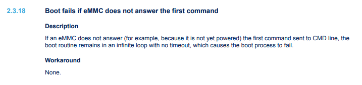

2022-11-17 1:54 AM
Referred ES0438 regarding eMMC boot failure. Can you please confirm below eMMC boot failure issue also fixed on Rev.Z?
Regards,
Ganapathi

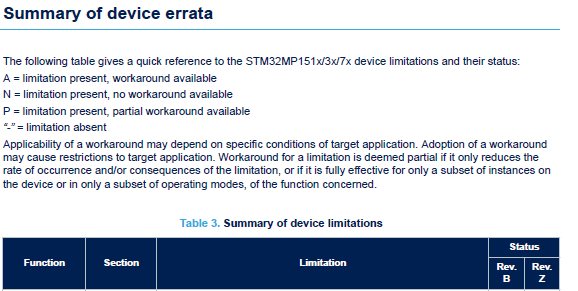

2022-11-17 2:42 AM
Yes, this one also is corrected.
All information about limitation presence on each revision are in ES0438 Table 3
Regards,
