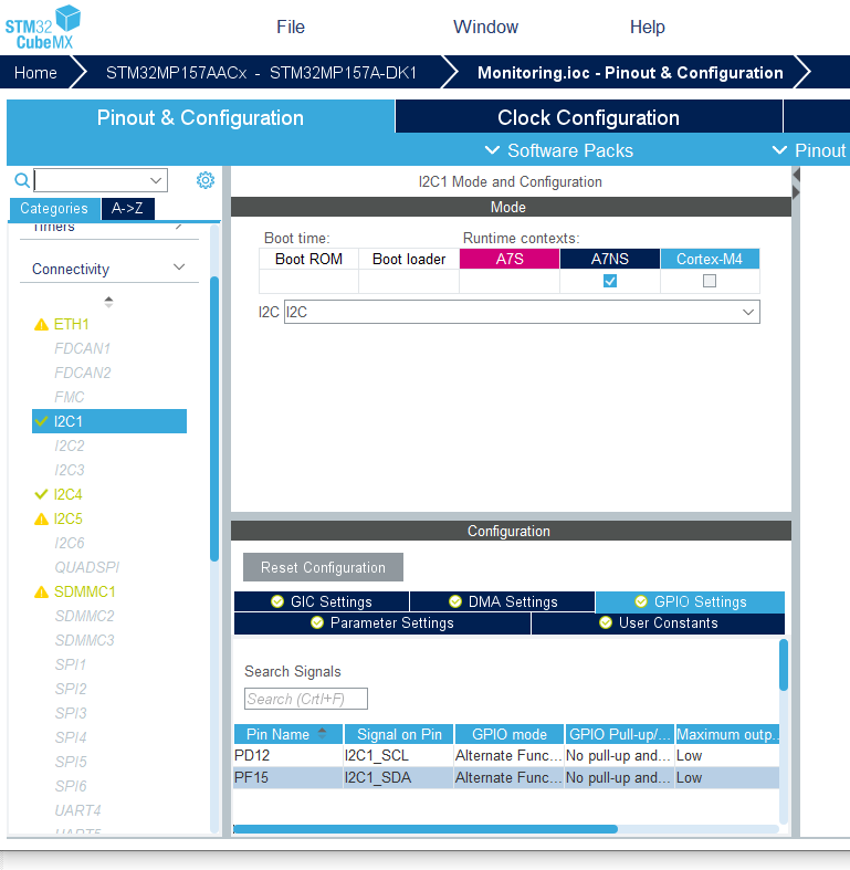

I'm trying to connect some sensors to the I2C1 connectors of the STM32MP157A-DK1 and read datas from a linux application (Cortex A7). It doesn't works...
But I successfully read data from the I2C5 connectors from the Cortex M4 processor.
I used the following configuration from STM32CubeMX for I2C1:
But when i run

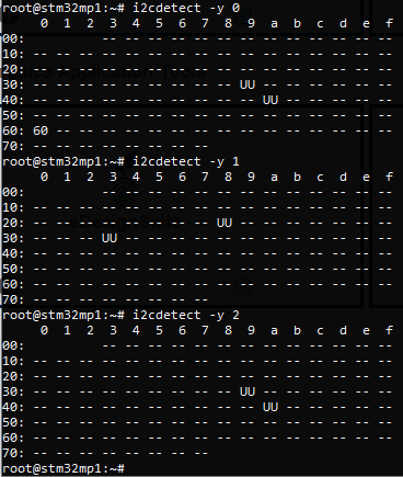

#i2cdetect -y 0
#i2cdetect -y 1
#i2cdetect -y 2I don't see any of my devices:

Ok i just found that the Device Tree for Cortex A7 generated from STM32CubeMX is not automatically uploaded to the STM board when i run the M4 project.
The solution was to follow this tutorial to setup an OpenSTLinux project then run A7 project or manually copy generated .dtb to "/boot/stm32mp157a-dk1.dtb" (set correct card name)
I didn't see any documentation about this process? Something like : "How to use device tree generated by STMCubeMX"
