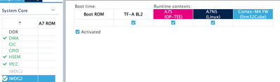

Finally, I resolved a panic problem. The problem was related to iwdg2. Cube generates an iwdg2 section but without providing information into
&etzpc {
DECPROT(STM32MP1_ETZPC_IWDG2_ID, DECPROT_S_RW, DECPROT_UNLOCK)
When I change iwdg2 to iwdg1 cube put the above information for IWDG1. I'm not sure if it is a feature or a bug.

Regarding IWDG2 I misunderstand the checkbox in the cube

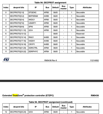

The checkbox does not always mean that the peripheral is secured. In the documentation, I found confirmation of what You wrote above.
Documentation source RM0436 Rev 6 page 1121
Now I understand how many things I do wrong, and what I should fix in my dts files.
