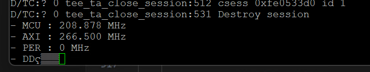

I Also have a this problem where u-boot stops at the clock 151. On thing worth to note that for me if I turn off debug printing Linux will boot just fine so u-boot must somehow run but it stops printing around the DDR frequency printing. So we are able to use the system but it's more or less a requirement that we should be able to enter u-boot.
optee optee: OP-TEE: revision 3.19 (afacf356) Clocks:
- MPU : 650 MHz
- MCU : 64 MHz
- AXI : 133 MHz
- PER : 64 MHz
- DDR ��M&&j!�5

I have the exact same problem as well, it stops u-boot uart at - DDR (some times bad characters comes her so it seems the UART is abruptly stopped) and if I enable debugging it stops at enabling clock 151. One thing worth noting is that it seems to be the u-boot console that is not working, Linux boots just fine as long as i disable the debug log. I would like to acces the uboot console so I would be very interested in what this known bug in the ECO is, is there a place where these known bugs are written down???
